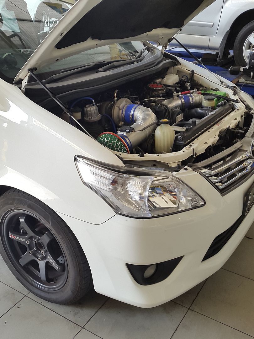

Post by htannis »
xtr40rd1n4rym4n wrote:Ngiler liat improvementnya Om Htannis.
DC habis brp dan share list upgradenya donk Om.
already sold :
New brembo brakes
NEW YOUTUBE VIDEO
prove of the FASTEST Innova 2kd D4D a/t only with WMI without NOS
http://m.youtube.com/watch?v=BUSER9umG-w
old video
http://m.youtube.com/watch?v=hTudLc2PD4s
MESIN :
- 2kd engine (REMOVE)
- 1KD 3050cc engine (INSTALLED)
- Ecushop Monster max with SVC controller + dastek q+ with throttle module
- Turbo borgwarner, max boost : 2.5 bar (SOLD)
- nozzle edu2 2.7bar (SOLD)
- Holset hx32 turbo
- PRC external wastegate
- Nozzle edu3 denso 58psi
- Custom ex camchaft from thailand
- Custom Intercooler kit by REV
- Water Methanol Injection Stage 2
- EGR removed
- Intake custom bangmod
- Fuel Pressure regurator AEM
- Custom surge tank made in thai
- Fuel pump Walbro
- NOS 50 HP (SOLD)
RESULT : 400HP/700NM at @4000rpm (OLDSPEC WITH 2KD)
- 402M IN 12.903 SECOND (include Reaction Time proven in real drag race events in sentul circuit)
- 0 TO 100kmh in 5 second
interior :
- ecushop monster gauge
- real italian leader
- custom launch control button
- custom wmi on/off button
- WMI adjust gauge
- Shadow boost gauge + egt gauge
- GIZMO electronik boost controller built in turbo timer
kaki2 :
- shock hotbits dt-1 + per hotbits merah adjustable height and hard/soft front and rear
- velg compomotive type te37sl
- ban bridgestone ar20 225/55/17
rem depan :
- motul dot4 rbf
- rs pro brainded steel brake line
- Brembo 4 pot Big Brake Kit with 320mm rotor
- Brembo brake pad
rem belakang :
- standard
gearbox :
- standard automatic gearbox upgrade with transgo kit : HOTROD mode
- atf cooler
- fuel cooler
exhaust system
- modified KANSAI downpipe
- custom stainless steel front pipe 3"
- KANSAI freeflow muffler oem fit
- QTP cut off valve
di majalah car and tuning guide edisi 492 :
Foto2 lain :
engine bay setelah rapi
0-100kmh (OLD SPEC)
*map biru(belum full power) boost 2.1 bar + WMI on
