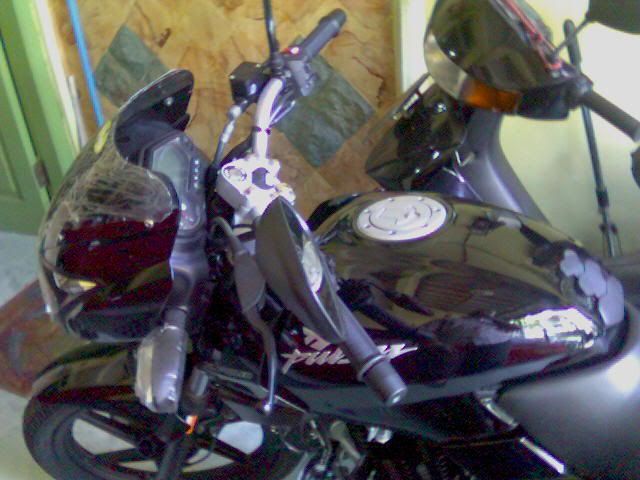

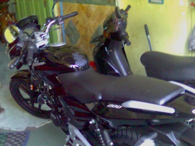

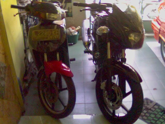

hanx13
Posts: 1214
Joined: Thu Apr 24, 2008 17:01
Location: -=SURABAYA=-
Re: review Pulsar-200
Post by hanx13 »
sori neh keburu2....+pake HP...:(
Dies-natalies ma kendaraan gw yg lama....hiks..hikss...
semoga si moo ini far better than old shogie...:)

novasonic
Posts: 1237
Post by novasonic »
hanx13 wrote:sori neh keburu2....+pake HP...:(
Pasti far more better bro.......
Btw drive safe ok......
Mantaff pic-nya bro, welcome to da club!!!!
