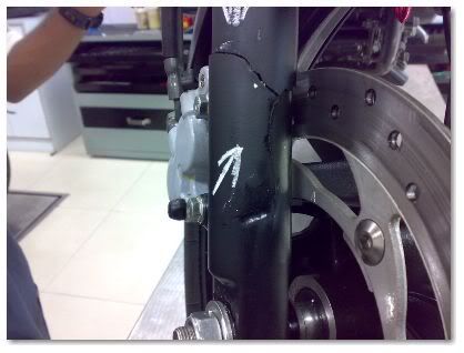

please be careful yah ada beberapa report di india yg menyebutkan shock depan pulsar patah di bagian tabungnya (retak mungkin disebabkan menghajar lubang dengan kecepatan tinggi)

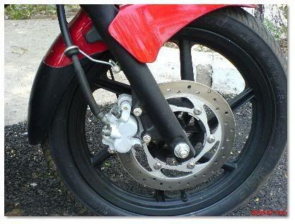

My friend Nilu (Since our B.E days) recently got himself a new RED Pulsar 200 DTSi. The Picture posted below is the Pic of his new bike which he had mailed to me. Congrats Nilu..!!
The front fork barrels of the first batch of Pulsar 200 were prone to breakage under heavy braking...
It was probably due to faulty design of the front fork barrel.

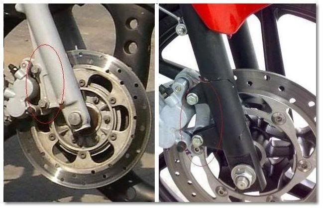

A comparision of the front fork barrels of the Pulsar 180 (on the left) and the Pulsar 200 (on the right) below shows the difference between the two designs
Following customer complaints, Bajaj has promptly replaced the older front fork barrels with a new design. As can be see from the pics of Nilu's Bike, the front fork barrels of the new Bajaj Pulsar DTSi 200 C.C has been replaced with a new design.

Dari segi penampilan sih memang lebih keren yang pecah itu. Tapi kalau dari kekuatan menahan beban kayaknya memang lebih kuat yang model shock Pulsar 180 yah, Thx infonya bro azisdth.

Coba deh liat yang gambar perbandingan shock yang rusak (kanan) dan yang kuat (kiri)...... Nah shock yang kita pake itu yang sebelah kiri bro.....
